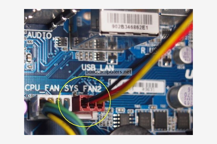

I think KingJohn means that you should connect the fan's connectors into their own 3-pin or 4-pin fan header on your motherboard, IF you have two or more pins on the motherboard for fans, like this:
If you use the 4-pin fan header on your motherboard the fans will be regulated by the motherboard according to the temperature. If its cold the fan goes slow and if its warm the fan goes fast.
Every pin can on better mobos handle maybe up to 2A (24W), budget ones maybe 1A (12W).
If you only have one pin fan header on the motherboard: Then I would say it should be OK to connect both fans to the same pin fan header on your motherboard (if your motherboard is not a extreme budget one). First I would check the motherboard specs for how much power the header can deliver (voltage(V) x current(A) = watts(W)).
  • 3 pin = Corsair say "Motherboard with an open standard 3-pin fan connector".
    ==> Note: when using a 3-pin power connector with a 4-pin fan header, the fan will always be on; there is no fan control.
  • 4 pin = Coolermaster say "Connector 4-Pin"
So you can plug them both into the same mobo power connctor (CPU Fan), but the Corsair will always be on and the Coolmaster will be regulated according to temperature.
